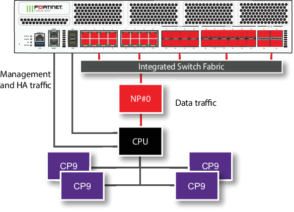

FortiGate 1800F and 1801F fast path architecture
The FortiGate 1800F and 1801F models feature the following front panel interfaces:
  • Two 10/100/1000BASE-T Copper (MGMT1 and MGMT2), not connected to the NP7 processor.
  • Two 10 GigE SFP+ (HA1 and HA2), not connected to the NP7 processor.
  • Sixteen 10/100/1000BASE-T Copper (1 to 16).
  • Eight 1 GigE SFP (17 to 24).
  • Twelve 10/25 GigE SFP+/SFP28 (25 to 36), interface groups: 25 - 28, 29 - 32, and 33 - 36.
  • Four 40 GigE QSFP+ (37 to 40).
The FortiGate 1800F and 1801F each include one NP7 processor. All front panel data interfaces and the NP7 processor connect to the integrated switch fabric (ISF). All data traffic passes from the data interfaces through the ISF to the NP7 processor. All supported traffic passing between any two data interfaces can be offloaded by the NP7 processor. Data traffic processed by the CPU takes a dedicated data path through the ISF and the NP7 processor to the CPU.
The MGMT interfaces are not connected to the NP7 processor. Management traffic passes to the CPU over a dedicated management path that is separate from the data path. You can also dedicate separate CPU resources for management traffic to further isolate management processing from data processing (see Dedicated management CPU).
The HA interfaces are also not connected to the NP7 processor. To help provide better HA stability and resiliency, HA traffic uses a dedicated physical control path that provides HA control traffic separation from data traffic processing.
The separation of management and HA traffic from data traffic keeps management and HA traffic from affecting the stability and performance of data traffic processing.

The command output also shows the maximum speeds of each interface. Also, interfaces 1 to 24 are connected to one switch and interfaces 25 to 40 are connected to another switch. Both of these switches make up the internal switch fabric, which connects the interfaces to the NP7 processor, the CPU, and the four CP9 processors.
The NP7 processor has a bandwidth capacity of 200 Gigabits. You can see from the command output that if all interfaces were operating at their maximum bandwidth the NP7 processor would not be able to offload all the traffic.
The FortiGate-1800F and 1801F can be licensed for hyperscale firewall support, see the Hyperscale Firewall Guide.

Interface groups and changing data interface speeds
FortiGate-1800F and 1801F front panel data interfaces 25 to 36 are divided into the following groups:
  • port25 - port28
  • port29 - port32
  • port33 - port36
All of the interfaces in a group operate at the same speed. Changing the speed of an interface changes the speeds of all of the interfaces in the same group. For example, if you change the speed of port26 from 10Gbps to 25Gbps the speeds of port25 to port28 are also changed to 25Gbps.

Configuring NPU port mapping
You can use the following command to configure FortiGate-1800F and 1801F NPU port mapping:
config system npu
config port-npu-map
edit <interface-name>
set npu-group-index <index>
You can use the port map to assign data interfaces to NP7 links.
Each NP7 has two 100-Gigabit KR links, numbered 0 and 1. Traffic passes to the NP7 over these links. By default the two links operate as a LAG that distributes sessions to the NP7 processor. You can configure the NPU port map to assign interfaces to use one or the other of the NP7 links instead of sending sessions over the LAG.
<index> varies depending on the NP7 processors available in your FortGate.
For the FortiGate-1800F <index> can be 0, 1, or 2:
  • 0, assign the interface to NP#0, the default, the interface is connected to the LAG. Traffic from the interface is distributed to both links.
  • 1, assign the interface to NP#0-link0, to connect the interface to NP7 link 0. Traffic from the interface is set to link 0.
  • 2, assign the interface to NP#0-link1, to connect the interface to NP7 link 1. Traffic from the interface is set to link 1.
For example, use the following syntax to assign the FortiGate-1800F front panel 40Gigabit interfaces 37 and 38 to NP#0-link0 and interfaces 39 and 40 to NP#0-link 1. The resulting configuration splits traffic from the 40Gigabit interfaces between the two NP7 links:
