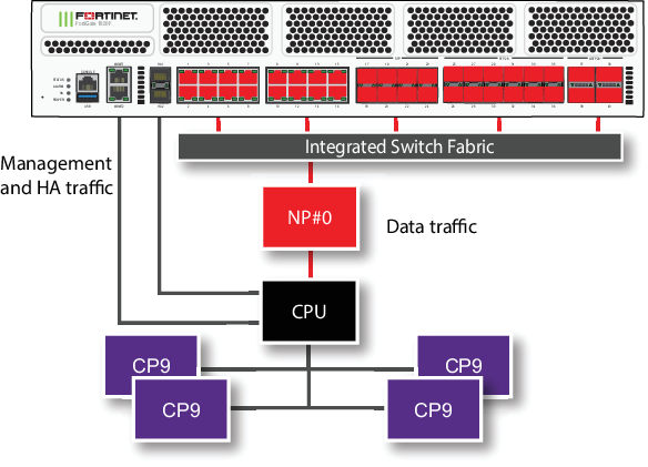

FortiGate 1800F and 1801F fast path architecture
The FortiGate 1800F and 1801F each include one NP7 processor. All front panel data interfaces and the NP7 processor connect to the integrated switch fabric (ISF). All data traffic passes from the data interfaces through the ISF to the NP7 processor. All supported traffic passing between any two data interfaces can be offloaded by the NP7 processor. Data traffic processed by the CPU takes a dedicated data path through the ISF and the NP7 processor to the CPU.

The MGMT interfaces are not connected to the NP7 processor. Management traffic passes to the CPU over a dedicated management path that is separate from the data path. You can also dedicate separate CPU resources for management traffic to further isolate management processing from data processing (see Improving GUI and CLI responsiveness (dedicated management CPU)).
The HA interfaces are also not connected to the NP7 processor. To help provide better HA stability and resiliency, HA traffic uses a dedicated physical control path that provides HA control traffic separation from data traffic processing.
The separation of management and HA traffic from data traffic keeps management and HA traffic from affecting the stability and performance of data traffic processing.
You can use the following command to display the FortiGate 1800F or 1801F NP7 configuration. The command output shows a single NP7 named NP#0 is connected to all interfaces. This interface to NP7 mapping is also shown in the diagram above.
diagnose npu np7 port-list Front Panel Port: Name Max_speed(Mbps) Dflt_speed(Mbps) Sw_Trunk_Id Sw_Tcam_Id Group_from_vdom Switch_id SW_port_id SW_port_name -------- --------------- --------------- --------------- ---------- --------------- --------- ---------- ------------ port1 1000 1000 8 1 1 0 3 n/a port2 1000 1000 8 2 1 0 2 n/a port3 1000 1000 8 3 1 0 5 n/a port4 1000 1000 8 4 1 0 4 n/a port5 1000 1000 8 5 1 0 7 n/a port6 1000 1000 8 6 1 0 6 n/a port7 1000 1000 8 7 1 0 9 n/a port8 1000 1000 8 8 1 0 8 n/a port9 1000 1000 8 9 1 0 11 n/a port10 1000 1000 8 10 1 0 10 n/a port11 1000 1000 8 11 1 0 13 n/a port12 1000 1000 8 12 1 0 12 n/a port13 1000 1000 8 13 1 0 15 n/a port14 1000 1000 8 14 1 0 14 n/a port15 1000 1000 8 15 1 0 17 n/a port16 1000 1000 8 16 1 0 16 n/a port17 1000 1000 8 17 1 0 18 n/a port18 1000 1000 8 18 1 0 19 n/a port19 1000 1000 8 19 1 0 20 n/a port20 1000 1000 8 20 1 0 21 n/a port21 1000 1000 8 21 1 0 22 n/a port22 1000 1000 8 22 1 0 23 n/a port23 1000 1000 8 23 1 0 24 n/a port24 1000 1000 8 24 1 0 25 n/a port25 25000 10000 8 25 1 1 15 n/a port26 25000 10000 8 26 1 1 16 n/a port27 25000 10000 8 27 1 1 13 n/a port28 25000 10000 8 28 1 1 14 n/a port29 25000 10000 8 29 1 1 19 n/a port30 25000 10000 8 30 1 1 20 n/a port31 25000 10000 8 31 1 1 17 n/a port32 25000 10000 8 32 1 1 18 n/a port33 25000 10000 8 33 1 1 23 n/a port34 25000 10000 8 34 1 1 24 n/a port35 25000 10000 8 35 1 1 21 n/a port36 25000 10000 8 36 1 1 22 n/a port37 100000 100000 8 37 1 1 29 n/a port38 100000 100000 8 38 1 1 25 n/a port39 100000 100000 8 39 1 1 33 n/a port40 100000 100000 8 40 1 1 37 n/a -------- --------------- --------------- --------------- ---------- --------------- --------- ---------- ------------ Name sw_id hash nr_link valid default sw_tid -------- --------------------------------------- -------- --------------------------------------- NP Port: Name Switch_id SW_port_id SW_port_name ------ --------- ---------- ------------ np0_0 1 41 n/a np0_1 1 45 n/a ------ --------- ---------- ------------ * Max_speed: Maximum speed, Dflt_speed: Default speed * SW_port_id: Switch port ID, SW_port_name: Switch port name
The command output also shows the maximum speeds of each interface. Also, interfaces 1 to 24 are connected to one switch and interfaces 25 to 40 are connected to another switch. Both of these switches make up the internal switch fabric, which connects the interfaces to the NP7 processor, the CPU, and the four CP9 processors.
The NP7 processor has a bandwidth capacity of 200 Gigabits. You can see from the command output that if all interfaces were operating at their maximum bandwidth the NP7 processor would not be able to offload all the traffic.
