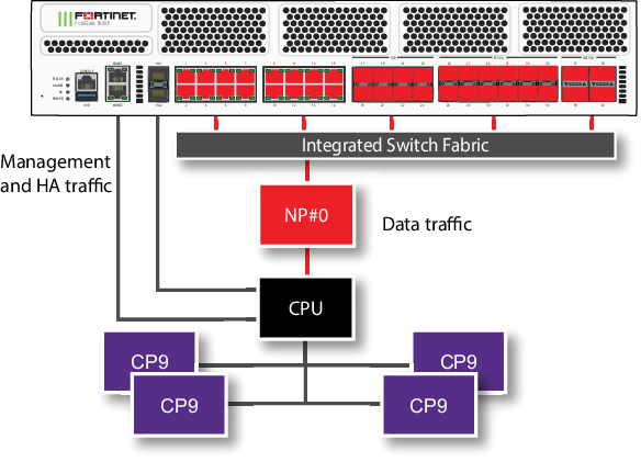

FortiGate 1800F and 1801F fast path architecture
The FortiGate 1800F and 1801F each include one NP7 processor. All front panel data interfaces and the NP7 processor connect to the integrated switch fabric (ISF). All data traffic passes from the data interfaces through the ISF to the NP7 processor. All supported traffic passing between any two data interfaces can be offloaded by the NP7 processor. Data traffic processed by the CPU takes a dedicated data path through the ISF and the NP7 processor to the CPU.
FortiOS 7.2.8 includes a software update that allows the FortiGate 1800F and 1801F interfaces 37 to 40 to be configured as 40 GigE QSFP+ or 100 GigE QSFP28 interfaces. You can set the interface speed to 40000full (40G full-duplex) and install 40G QSFP+ transceivers in these interfaces and operate them as 40G interfaces. You can also set the interface speed to 100Gfull (100G full-duplex) and install 100G QSFP28 transceivers in these interfaces and operate them as 100G QSFP28 interfaces.
The FortiGate 1800F and 1801F feature the following front panel interfaces:
  • Two 1 GigE RJ45 (MGMT1 and MGMT2), not connected to the NP7 processor.
  • Two 10 GigE SFP+ (HA1 and HA2), not connected to the NP7 processor.
  • Sixteen 10/100/1000BASE-T RJ45 (1 to 16).
  • Eight 1 GigE SFP (17 to 24).
  • Twelve 25/10 GigE SFP28/SFP+ (25 to 36), interface groups: 25 - 28, 29 - 32, and 33 - 36.
  • Four 100/40 GigE QSFP28/QSFP+ (37 to 40). Each of these interfaces can be split into four 25/10/1 GigE SFP28 interfaces.
The MGMT interfaces are not connected to the NP7 processor. Management traffic passes to the CPU over a dedicated management path that is separate from the data path. You can also dedicate separate CPU resources for management traffic to further isolate management processing from data processing (see Improving GUI and CLI responsiveness (dedicated management CPU)).
The HA interfaces are also not connected to the NP7 processor. To help provide better HA stability and resiliency, HA traffic uses a dedicated physical control path that provides HA control traffic separation from data traffic processing.
The separation of management and HA traffic from data traffic keeps management and HA traffic from affecting the stability and performance of data traffic processing.

port13   1000            1000             NP#0            0         15         ge13
port14   1000            1000             NP#0            0         14         ge12
port15   1000            1000             NP#0            0         17         ge15
port16   1000            1000             NP#0            0         16         ge14
port17   1000            1000             NP#0            0         18         ge16
port18   1000            1000             NP#0            0         19         ge17
port19   1000            1000             NP#0            0         20         ge18
port20   1000            1000             NP#0            0         21         ge19
port21   1000            1000             NP#0            0         22         ge20
port22   1000            1000             NP#0            0         23         ge21
port23   1000            1000             NP#0            0         24         ge22
port24   1000            1000             NP#0            0         25         ge23
port25   25000           10000            NP#0            1         15         xe14
port26   25000           10000            NP#0            1         16         xe15
port27   25000           10000            NP#0            1         13         xe12
port28   25000           10000            NP#0            1         14         xe13
port29   25000           10000            NP#0            1         19         xe18
port30   25000           10000            NP#0            1         20         xe19
port31   25000           10000            NP#0            1         17         xe16
port32   25000           10000            NP#0            1         18         xe17
port33   25000           10000            NP#0            1         23         xe22
port34   25000           10000            NP#0            1         24         xe23
port35   25000           10000            NP#0            1         21         xe20
port36   25000           10000            NP#0            1         22         xe21
port37   100000          100000           NP#0            1         29         xe25
port38   100000          100000           NP#0            1         25         xe24
port39   100000          100000           NP#0            1         33         xe26
port40   100000          100000           NP#0            1         37         xe27
NP Port:
Name   Switch_id SW_port_id SW_port_name
np0_0  1         41         ce0
np0_1  1         45         ce1
* Max_speed: Maximum speed, Dflt_speed: Default speed
* SW_port_id: Switch port ID, SW_port_name: Switch port name
The command output also shows the maximum speeds of each interface. Also, interfaces 1 to 24 are connected to one switch and interfaces 25 to 40 are connected to another switch. Both of these switches make up the internal switch fabric, which connects the interfaces to the NP7 processor, the CPU, and the four CP9 processors.
The NP7 processor has a bandwidth capacity of 200 Gigabits. You can see from the command output that if all interfaces were operating at their maximum bandwidth the NP7 processor would not be able to offload all the traffic.
The FortiGate-1800F and 1801F can be licensed for hyperscale firewall support, see the Hyperscale Firewall Guide.
Interface groups and changing data interface speed, media type, or FEC setting
FortiGate-1800F and 1801F front panel data interfaces 25 to 36 are divided into the following groups:

Splitting the port37 to port40 interfaces
You can use the following command to split each FortiGate 1800F and 1801F 37 to 40 (port37 to port40) 100/40 GigE QSFP28 interface into four 25/10/1 GigE SFP28 interfaces. For example, to split interfaces 37 and 39 (port37 and port39), enter the following command:
config system global
set split-port port37 port39
The FortiGate 1800F and 1801F restarts and when it starts up:
  • The port37 interface has been replaced by four SFP28 interfaces named port37/1 to port37/4.
  • The port39 interface has been replaced by four SFP28 interfaces named port37/1 to port37/4.
A configuration change that causes a FortiGate to restart can disrupt the operation of an FGCP cluster. If possible, you should make this configuration change to the individual FortiGates before setting up the cluster. If the cluster is already operating, you should temporarily remove the secondary FortiGate(s) from the cluster, change the configuration of the individual FortiGates and then re-form the cluster. You can remove FortiGate(s) from a cluster using the Remove Device from HA cluster button on the System > HA GUI page. For more information, see Disconnecting a FortiGate.
By default, the speed of each split interface is set to 10000full (10GigE). These interfaces can operate as 25GigE, 10GigE, or 1GigE interfaces depending on the transceivers and breakout cables. You can use the config system interface command to change the speeds of the split interfaces.
If you set the speed of one of the split interfaces to 25000full (25GigE), all of the interfaces are changed to operate at this speed (no restart required). If the split interfaces are set to 25000full and you change the speed of one of them to 10000full (10GigE) they are all changed to 10000full (no restart required). When the interfaces are operating at 10000full, you can change the speeds of individual interfaces to operate at 1000full (1GigE).
Configuring NPU port mapping
You can use the following command to configure FortiGate-1800F and 1801F NPU port mapping:
config system npu
config port-npu-map
edit <interface-name>
set npu-group-index <index>
You can use the port map to assign data interfaces to NP7 links.
Each NP7 has two 100-Gigabit KR links, numbered 0 and 1. Traffic passes to the NP7 over these links. By default the two links operate as a LAG that distributes sessions to the NP7 processor. You can configure the NPU port map to assign interfaces to use one or the other of the NP7 links instead of sending sessions over the LAG.
<index> varies depending on the NP7 processors available in your FortiGate.
For the FortiGate-1800F <index> can be 0, 1, or 2:
  • 0, assign the interface to NP#0, the default, the interface is connected to the LAG. Traffic from the interface is distributed to both links.
  • 1, assign the interface to NP#0-link0, to connect the interface to NP7 link 0. Traffic from the interface is set to link 0.
  • 2, assign the interface to NP#0-link1, to connect the interface to NP7 link 1. Traffic from the interface is set to link 1.
For example, use the following syntax to assign the FortiGate-1800F front panel 100Gigabit interfaces 37 and 38 to NP#0-link0 and interfaces 39 and 40 to NP#0-link 1. The resulting configuration splits traffic from the 100Gigabit interfaces between the two NP7 links:
config system npu
config port-npu-map
edit port37
set npu-group-index 1
edit port38
edit port39
set npu-group-index 2
edit port40
You can use the diagnose npu np7 port-list command to see the current NPU port map configuration. While the FortiGate-1800F or 1801F is processing traffic, you can use the diagnose npu np7 cgmac-stats <npu-id> command to show how traffic is distributed to the NP7 links.
For example, after making the changes described in the example, the np_group column of the diagnose npu np7 port-list command output for port37 to port40 shows the new mapping:
