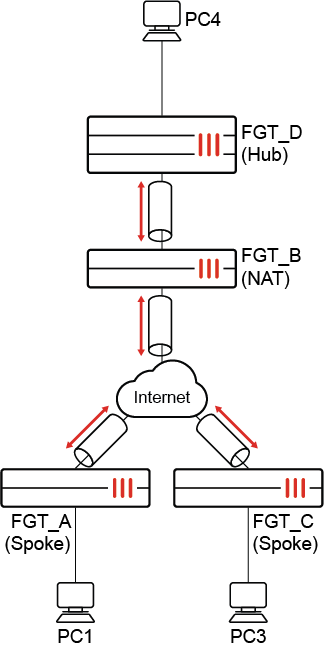

Example
In this example, IPsec VPN crosses over a carrier network and UDP packets are not allowed.
To encapsulate ESP packets within TCP headers:

  3. Configure the FGT_A (spoke) FortiGate.

  4. Configure the FGT_C (spoke) FortiGate.

  5. Configure the FGT_D (hub) FortiGate.

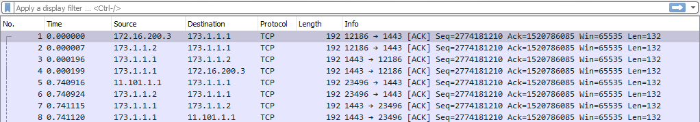

  7. Verify the ESP packets sniffed on the NAT device.
    In the packet capture, ESP packets are encapsulated into TCP ACK packets with the same sequence number. This is why anti-replay must be disabled on the NAT FortiGate.

              set dpd on-idle
              set transport tcp
              set fortinet-esp enable
              set psksecret **********
              set dpd-retryinterval 60
    2. Configure the IPsec phase 2 settings:
          edit "Hub"
              set phase1name "Hub"
              set proposal aes128-sha1 aes256-sha1 aes128-sha256 aes256-sha256 aes128gcm aes256gcm chacha20poly1305
