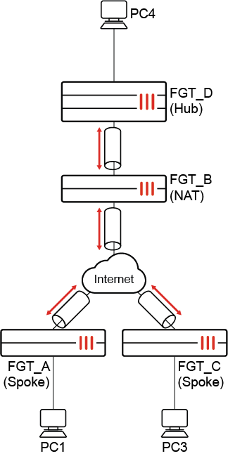

Example
In this example, IPsec VPN crosses over a carrier network and UDP packets are not allowed.
To encapsulate ESP packets within TCP headers:

      IKE and ESP will be encapsulated into TCP, and ESP packets encapsulated into a fake TCP header.

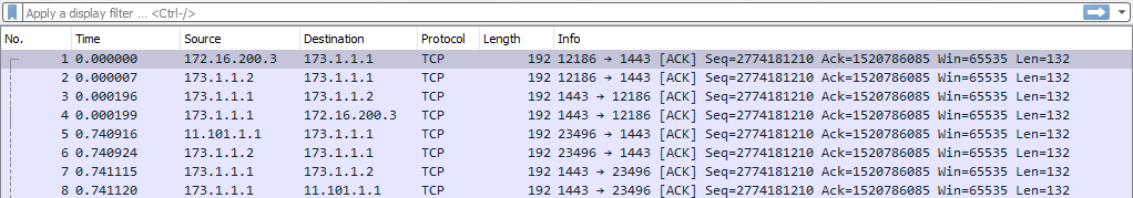

  7. Verify the ESP packets sniffed on the NAT device.
    In the packet capture, ESP packets are encapsulated into TCP ACK packets with the same sequence number. This is why anti-replay must be disabled on the NAT FortiGate.
