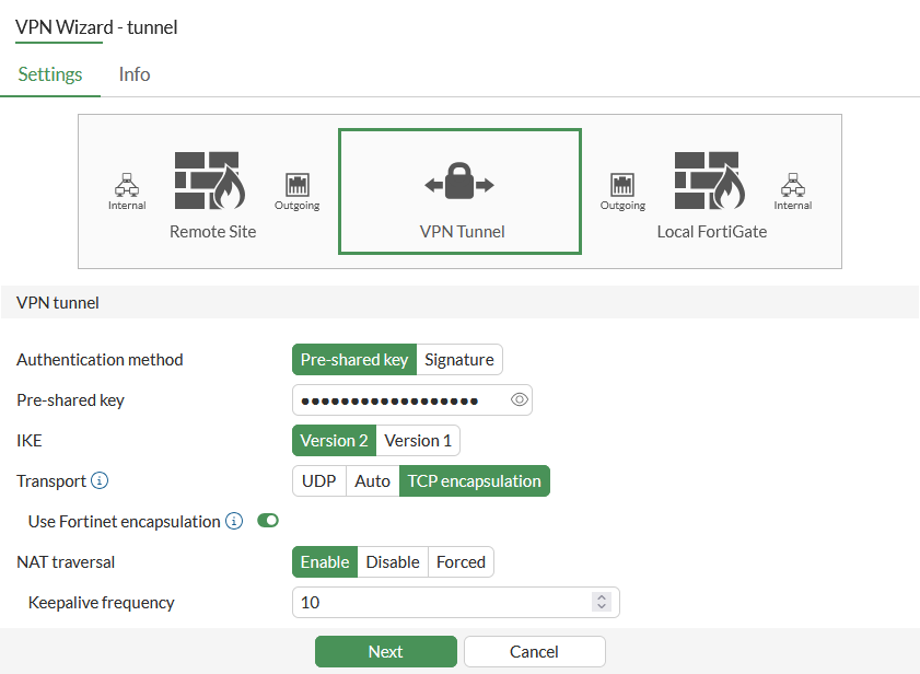

To configure TCP encapsulation for IPsec VPN in the GUI:
  1. Go to VPN > VPN Wizard.
  2. Enter a Tunnel name.
  3. Set Select a template to Site to Site
  4. Click Begin.
  5. Set Transport as needed.
    Use Fortinet encapsulation is only available when Transport is set to Auto or TCP encapsulation.
    When Transport is Auto, you can adjust the threshold for switching to TCP encapsulation using the auto-transport-threshold command in the CLI.
  6. Configure the remaining settings as needed and finish the wizard.

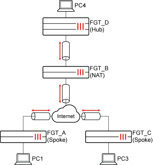

In this example, IPsec VPN crosses over a carrier network and UDP packets are not allowed.
To encapsulate ESP packets within TCP headers:

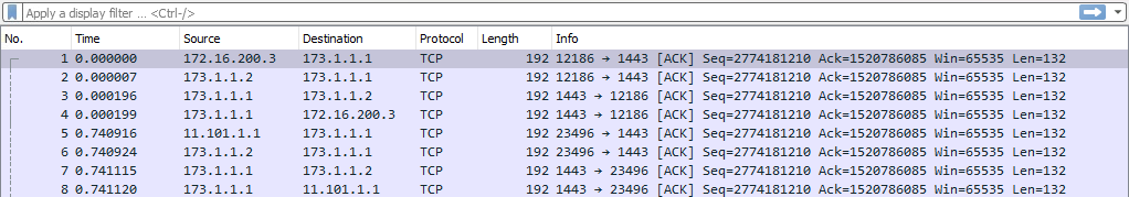

  7. Verify the ESP packets sniffed on the NAT device.
    In the packet capture, ESP packets are encapsulated into TCP ACK packets with the same sequence number. This is why anti-replay must be disabled on the NAT FortiGate.
