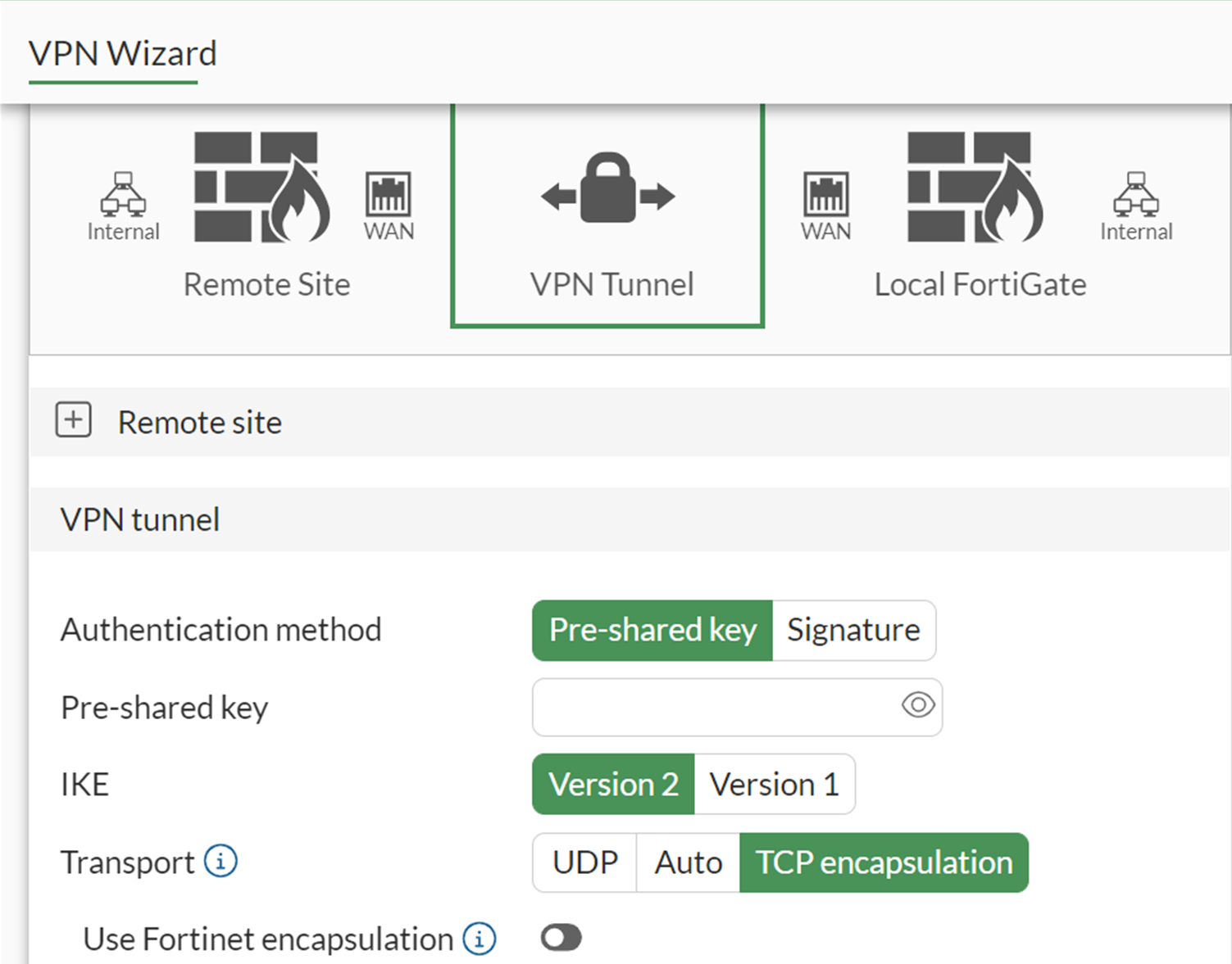

In the GUI, the VPN Wizard can be used to set the IKE transport protocol.
To set the IKE transport protocol in the GUI:
  1. Go to VPN > VPN Wizard.
  2. Enter a Tunnel name.
  3. For Select a template, select Site to Site, and click Begin.
  4. Configure the Remote Site settings as required, and click Next.
  5. Under VPN tunnel, set the Transport protocol as needed.
    The Use Fortinet encapsulation option displays only when Transport is set to TCP encapsulation. See Encapsulate ESP packets within TCP headers for more information.
    When Transport is set to Auto, you can adjust the threshold for switching to TCP encapsulation by using the set auto-transport-threshold command.
  6. Configure the remaining settings as needed.

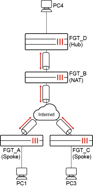

In this example, IPsec VPN crosses over a carrier network and UDP packets are not allowed.
To encapsulate ESP packets within TCP headers:

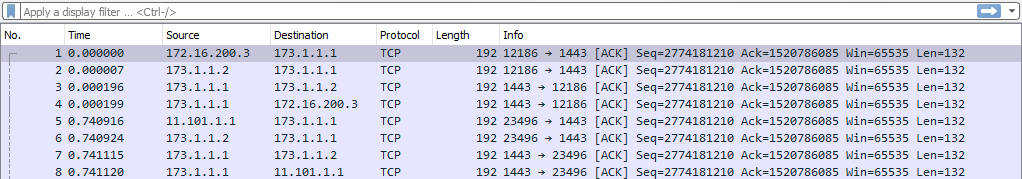

  7. Verify the ESP packets sniffed on the NAT device.
    In the packet capture, ESP packets are encapsulated into TCP ACK packets with the same sequence number. This is why anti-replay must be disabled on the NAT FortiGate.

    2. Configure the IPsec phase 2 settings:
          edit "spoke"
              set phase1name "spoke"
              set proposal aes128-sha1 aes256-sha1 aes128-sha256 aes256-sha256 aes128gcm aes256gcm chacha20poly1305
              set src-subnet 10.1.100.0 255.255.255.0
      IKE and ESP will be encapsulated into TCP, and ESP packets encapsulated into a fake TCP header.
  4. Configure the FGT_C (spoke) FortiGate.
