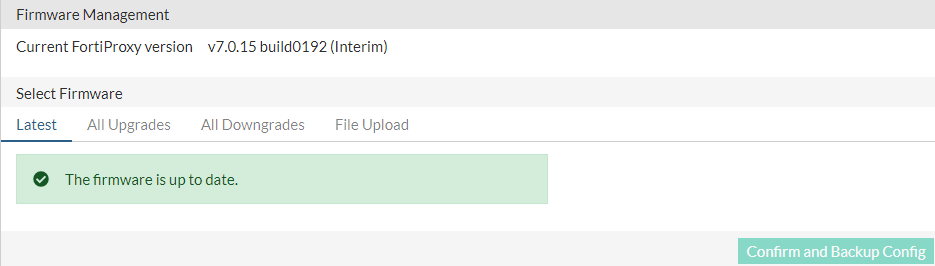

Firmware
Go to System > Firmware to check the current firmware version and to upload firmware from your computer or from FortiGuard.
You can upgrade you FortiProxy version by uploading a new firmware image from your computer:
- Download the target firmware from the Fortinet support site. See Downloading a firmware image
Go to System > Firmware.
In the File Upload tab, click Browse.
Select the file on your PC and click Open.
Click Confirm and Backup Config.
If you are upgrading from a mature to a feature firmware version, the Confirm pane opens with a warning message.
Review the warning, and click Confirm to continue. A warning message is displayed.
Click Continue to initiate the upgrade.
The FortiProxy unit backs up the current configuration to the management computer, uploads the firmware image file, upgrades to the new firmware version, and restarts. This process takes a few minutes.
You can also upgrade your FortiProxy by uploading a new firmware image under System > Fabric Management or from the CLI. See Upgrading individual device firmware.
