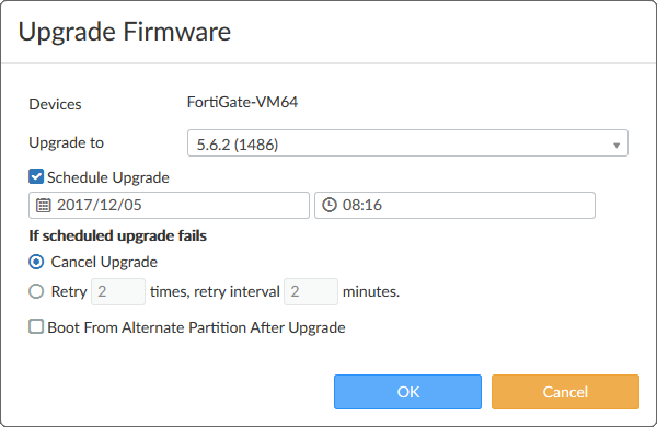

To upgrade a device’s firmware:
  1. Go to Device Manager.
  2. In the tree menu, select a device group, and then click the Firmware tab.
  3. Select a device or device group with an upgrade available that is licensed for firmware upgrades, then click Upgrade in either the toolbar or in the Upgrade Available column. The Upgrade Firmware dialog box opens.
  4. Configure the following settings, then click OK:
    Upgrade to
    Select a firmware version from the dropdown list.
    Schedule Upgrade
    Select to schedule the upgrade, then enter the date and time for the upgrade, and select an action to take if the update fails:
    • Cancel Upgrade
    • Retry: enter the number of times to retry and the time between retries.
    Boot From Alternate Partition After Upgrade
    Selecting this option causes the device to reboot twice during the upgrade process: first to upgrade the inactive partition, and second to boot back into the active partition.
    Upgrade to
    Schedule Upgrade
    • Cancel Upgrade
