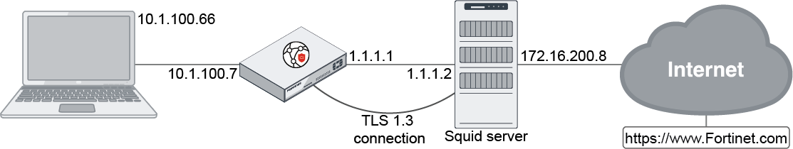

The following example involves a proxy chain of the Squid server and the FortiProxy, both of which can handle TLS 1.3 traffic.

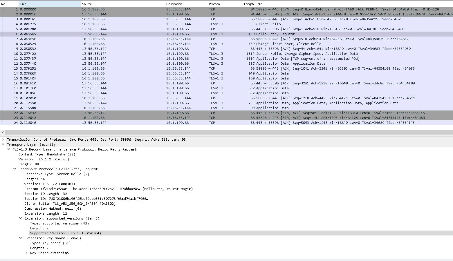

The following output from the Squid server demonstrates that the FortiProxy forwards the hello retry request back to the client PC. The client PC then sends the client hello again, and the connection is successfully established.

Example: Using TLS 1.3 with chaining proxy forwarding servers
